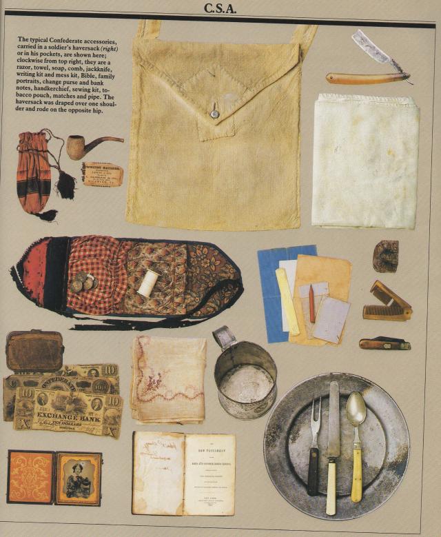

Et hop, je dégaine mon Confederate sketchbook !
PostPosted: Fri 17 Sep - 10:51 (2010)    Post subject: Confederate issue Haversack Reply with quote
tiré de "Time Life Series"

PostPosted: Fri 17 Sep - 11:24 (2010)    Post subject: Confederate issue Haversack Reply with quote
Merci beaucoup ! Y'a plus qu'à...
